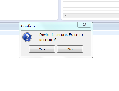

I have a Board with S12ZVL MCU embedded in it.when I try to debug a project and use U-Multilink .I'm getting this error "Device is secure .Erase to unsecure"
How do I solve this issue?

Hello Hui,
This issue is related to the connection of BDM interface, I can pick up some possible issue:
- The power supply should be 12 V
- Check the orientation of the BDM connector
- Check if the BDM cable is not damaged
- Check if the MCU warms up (If yes, it can be damaged)
- Do you have connected more than one BDM interface?
- You can try to use different USB PORT
I hope it helps.

Please make sure your MCU is powered, as well check if you didn't reverse BDM connector, check BDM cable.
