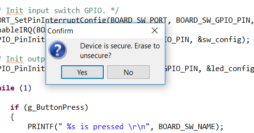

I have custom Board with K64 MCU embedded in it.when i try to flash the code via MCUXpresso and Multilink Debugger.Im getting this error "Device is secure .Erase to unsecure"

Please select yes to unsecure the chip.
In Flash address 0x40c is the Flash security byte. If this byte is changed to a error value, you'll see it. This value is set in startup_mk64fxxx12.c.
__attribute__ ((used,section(".FlashConfig"))) const struct {
    unsigned int word1;
    unsigned int word2;
    unsigned int word3;
    unsigned int word4;
} Flash_Config = {0xFFFFFFFF, 0xFFFFFFFF, 0xFFFFFFFF, 0xFFFFFFFE};  //if you dont want to secure the chip
Details please find in 29.34.3 Flash Security Register (FTFE_FSEC)
