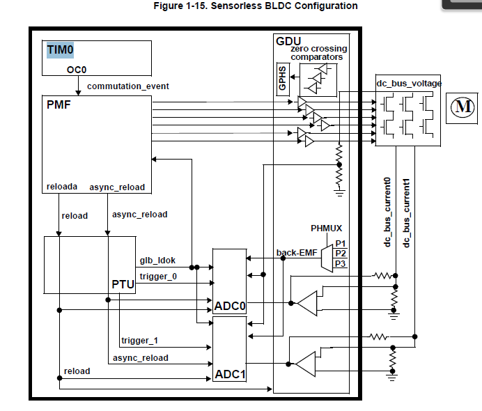

I have a sample code of sensorless control of 3 phase BLDC motor. In that I have observed that TIM0 is used for commutation event. Is it possible to change it to TIM1?
Thank you.
1,295 Views
danielmartynek
Only TIM0 OC0 is routed to PMF.
