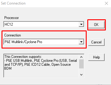

claudio_b
Diana,
I stopped at your point 5, because "check connection" doesn't work on my pc.
I found the solution with a patch by PEMicro:
PEmicro | Experts in Embedded tools for Flash Programming and Development
After having followed the instruction I stil had the problem: so I made Windows to search automatically a driver Update for Universal Multilink and after that all is OK.
I think the problem was only a driver issue

Thank you Diana, I installed CW 5.2 but when I start Hiwave the Multilink Universal is not found. May be the drivers are not installed? When can I find the Win10 driver?
Thank you
5,205 Views
dianabatrlova
Hello Claudio,
At first, please, try to connect the board by a procedure below:
1. connect the hardware with PC
2. start "Hiwave.exe"
3. go to menu Component -> Set Connection and select PE multilink -> OK
4. go to menu HC12MultilinkCyclonePro -> Set Derivative and select your MCU
5. go to menu HC12MultilinkCyclonePro -> Connection check connection -> Connect
6. menu File -> Load Application and import .s19 file.
