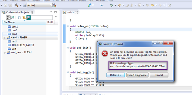

I was working with the projects in code warrior ide.
The same IDE when I started today is displaying some error.
I have attached the screen shot of that error. With this error I cannot debug or the flash the code, but I am able to compile the code.
Please let me know what has happened suddenly for the code warrior to behave in this manner.

MCU is S12Z and CW version is 11.1
3,166 Views
danielmartynek
In the picture you posted is KEAZ128 selected though:

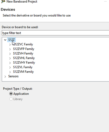

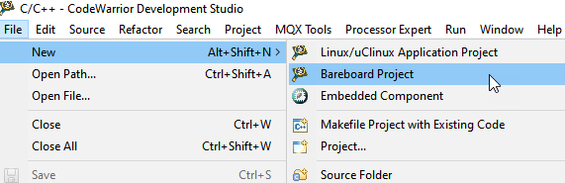

Please create a new project for the S12Z part that you have.
