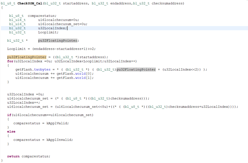

During my developing I need to calculate checksum of flash for an fixed area.  I use the method below to get every 4bytes from flash directly and sum them.
getFlash.twobytes = * ( (bl_u32_t *) ( (bl_u32_t)pu32FloatingPointer + (u32LocalIndex<<2)) )
But I find two issues:
1. It cost a lot of time, more than 20ms. We want it can decrease
2. some times it is not correct, seems one byte can not read out from flash, so the result is not correct(during debug, Still not find the root cause)
Could you please help if we can use some other method to get the target. Calculate checksum or CRC and compare with the result(we saved in a place before).

Do you calculate your sum from application image? Perhaps you didn't take into account security byte, which may be changed by your flash programmer? If you indeed take this into account, perhaps you should be aware about S12(X) vs S12Z difference. On older S12(X) after mass erase and unsecure flash state was all ones, even for security byte. Later, software like P&E Unsecure could program security byte to 0xFE (security off) to ease your debugging. On S12Z after unsecure command flash security byte is already 0xFE. It is provided by S12Z itself, not by software running on PC. Anyway I think you should remove security byte from your checksum check area.
  • 1. It cost a lot of time, more than 20ms. We want it can decrease
How many ms is acceptable? Do you want fast startup to functional state? What about fast startup as usual and checksum check in background? This would allow you to use slower but proper CRC, not just semi-working sum check.
192/4 = 48kDwords in 20ms at 32MHz  is ~13 bus cycles for one dword. Optimized loop code should look like this
L1:  add  D6, (X+)
  cmp  X, #top_of_flash
  blo    L1
This should take about 5 bus cycles for single Dword and thus still about 8ms for whole flash array. Reducing loop overhead and adding several Dwords per iteration will reduce effective cycles per dword to 3+, still about 5ms for whole array, if not more.

Hello Charles,
Ghm, didn't older CW for MCUs have option to erase/program only used flash/eeprom areas? I remember I had to use something like it in CW debugger settings to recover from S12Z machine exception on EEPROM ECC fault. I can't find such options in CW for MCUs 11.1. But if you had it enabled, it could lead as well to problems verifying checksum. You calculate checksum assuming all unused bytes are 0xFF, than if program gets shorter so that not all previously used sectors are erased.. checksum check will fail.
My asm pseudocode uses 32 bits checksum, easy to adapt to 16 bits, bit longer though.
Yes, C is always convenient and often as effective as assembler, provided your algorithm is effective and CPU friendly, as well C code should give optimizer close or even better nothing do do.
First line of your loop body 1) shifts index left, 2) adds result to pointer, then 3) dereferences pointer and 4) stores flash dword to some file or global scope variable. Then there are 4,5) two adds. Global scope variable reduces optimizers freedom to optimize that store out as not needed and reuse values in CPU registers instead. Local variable on stack should be better, I think. Then for loop 6) increments  index, 7) compares to the limit and 8) branches to the start of loop body. Optimizer may group and eliminate some of these steps, but not all. My code 1) dereferences pointer, reads and adds data to the checksum and advances pointer to the next location in one step, for 16 bits checksum it would be identical step 2).  3) compare pointer to the limit, 3) branch to start. Quite faster, isn't it?

I want to correct myself about execution times. First of all I missed that when branch is taken, which happens every time our loop continues, instruction queue refill takes place and eats additional 1-2 bus cycles. 1 is in the case L1 labels address is dword aligned, 2 in all other 3 cases. Another missed fact is default flash wait states setting. It is enabled by default and told to be 1 additional cycle. But wait states off vs wait states seems adding 1.5 bus cycles to single loop iteration with 32 bits fetch.
Real benchmarking. With L1 dword aligned and wait states switched off 32 bit fetch + add + shift + add takes 10 bus cycles per loop iteration (sindle dword). Wait state enabled +1 bus cycle, L1 misaligned +1 bus cycle.
Two 16 bit adds variant, L1 aligned, no wait states - 9.5 bus cycles. Wait states enabled - 11 bus cycles. I wonder why +1.5 bus cycles instead of +2. L1 misalignment should add one more bus cycle. So the best you can get is 11*192/4*1024 / 32M ~ 17ms. Wait states should be enabled above 25MHz, so practically no difference 32MHz with wait states or 25MHz without them.
