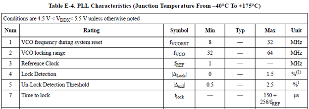

a) fosc – defines frequency of input clocks for CAN peripheral. It can be either oscillator clock or bus clock in dependence what is used in application.
Note: Because of CAN clock requirements I suggest to use oscillator clock as a source clock for CAN peripheral to meet oscillator precision parameter. The recommendation is based on the fact of that the PLL is usually used for bus clock generation and the PLL unlock parameter is usually out of clock specification. Especially un-lock parameter which can be observed and processed by PLL lock interrupt.
Only for example, S12ZVC defines:

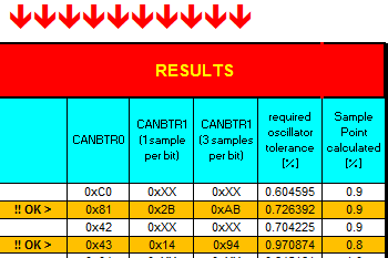

2) Output values
The results field show calculations for all combinations. The simplification, I use, is the max SJW is always used.
Lines containing correct values for bitrate setup are highlighted with orange color. The only thing which is not checked is sample point. You should check calculated “Sample point calculated” whether it corresponds to your requirements.
There are two correct values of CANBTR0 and CANBTR1 for required bitrate but the bottom orange line meets exactly our requirement for sample point.
