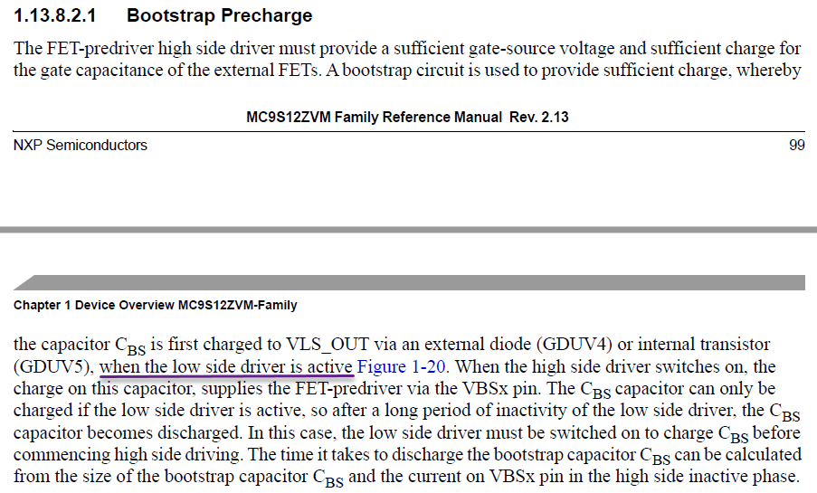

Hi all,
I am referring MC9S12ZVM-Family RM.(Rev 2.13)
In the chapter 1.13.8.2.1 Bootstrap Precharge
The below chunk of data :
***********************************************************Start**********************************************************
The bootstrap capacitors must be precharged before turning on the high-side drivers for the first time. This
can be done by using the PMF software output control mechanism:
PMFOUTC = 0x3F; // SW control on all outputs
PMFOUTB = 0x2A; // All high-sides off, all low-sides on
The PWM0 signals should be configured to start with turning on the low-side before the high-side drivers
in order to assure precharged bootstraps. Therefore invert the PWM0 signals:
PMFCINV = 0x3F; // Invert all channels to precharge
*********************************************************End*************************************************************
Query is whether the above advisory of pre-charging bootstrap and inverting PWM0 signals is applicable for all versions of GDU i.e. GDUV4, GDUV5, GDUV6 or for a specific version
Thanking in advance
Tags (2)
3,037 Views
danielmartynek
Hi Pratinha,
Yes, it applies to all the GDU versions.
Because the capacitor is charged only when the corresponding LS driver is active.
