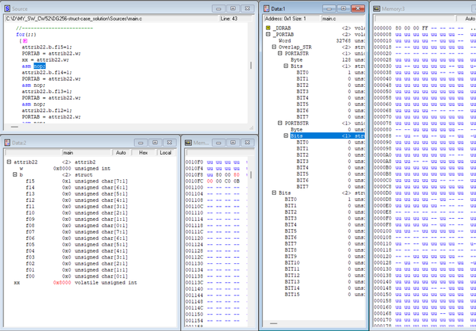

This behaviour is absolutely correct in the case of the S12 family. Higher byte is at the lower address.
The MCU is a big endian so word has always higher byte at lower address. As you can see for this configuration

Everything is correctly written. The highest bifield flag is written to the highest bit of the registers (word) PORTAB or a variable xx.
Of course, in the window Data1 you can see there is a bit 0 set but it is based on the definition in the device header file. (look into mc9s12dg256.h file in your project window and search for portab definition)
