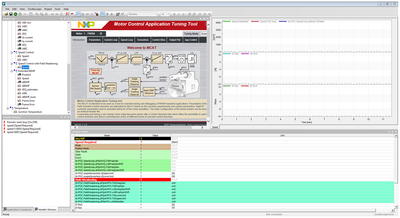

The field weakening function is placed in the stateRun() and guarded by an "if" block (main.c, line 967):
if(cntrState.usrControl.fieldWeakeningEnabled)
   AMCLIB_FW(drvFOC.iDQReq.f16Arg2,drvFOC.pospeControl.wRotElReq, &drvFOC.iDQReq,&drvFOC.FieldWeakening);
To tune up the FW, FreeMASTER project can be used (located in the {Projec}\FreeMASTER_control\MCSXSR1CS12ZVM_PMSM_SW_CW11.pmp). Navigate to the "Speed Control with Field Weakening" subblock and feel free to play around. However, it's worth to mention that the success of field weakening heavily depends on the motor type. For example, Linix motor 45zwn24-90-b can be forced to 1.4x speed above the base speed, while Linix 45zwn24-40 has difficulties to go beyond 1.1x of the base speed.
