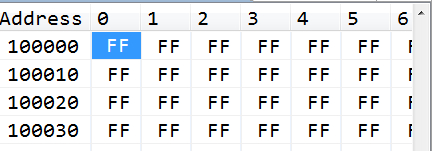

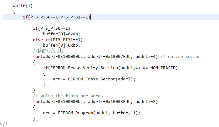

  I want to save a variable in the eeprom, I can read the variable after the power on reset.The follows is my code:
The data is saved in the address(0x100000~0x10003F), but after power on reset, the all values in the address (0x100000~0x10003F)  are 0xFF,why?

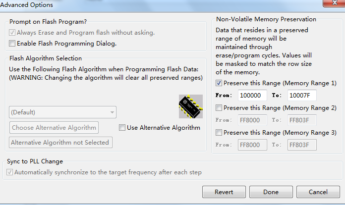

I have found the problem,it's debug configuration quenstion.

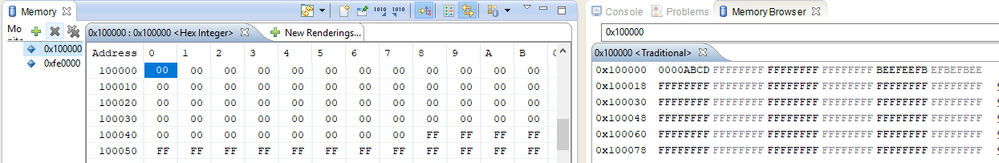

in last days I have met with similar issue. It looks like CW issue for this sector.
Could you please read the data from the sector by code step by step to check content at addresses 0x100000...0x1000FF?
BTW, there is another approach to read the memory. You should use another option to view the memory.
Go to option:     Window->Show View -> Memory Browser
The difference address 0x100000:
