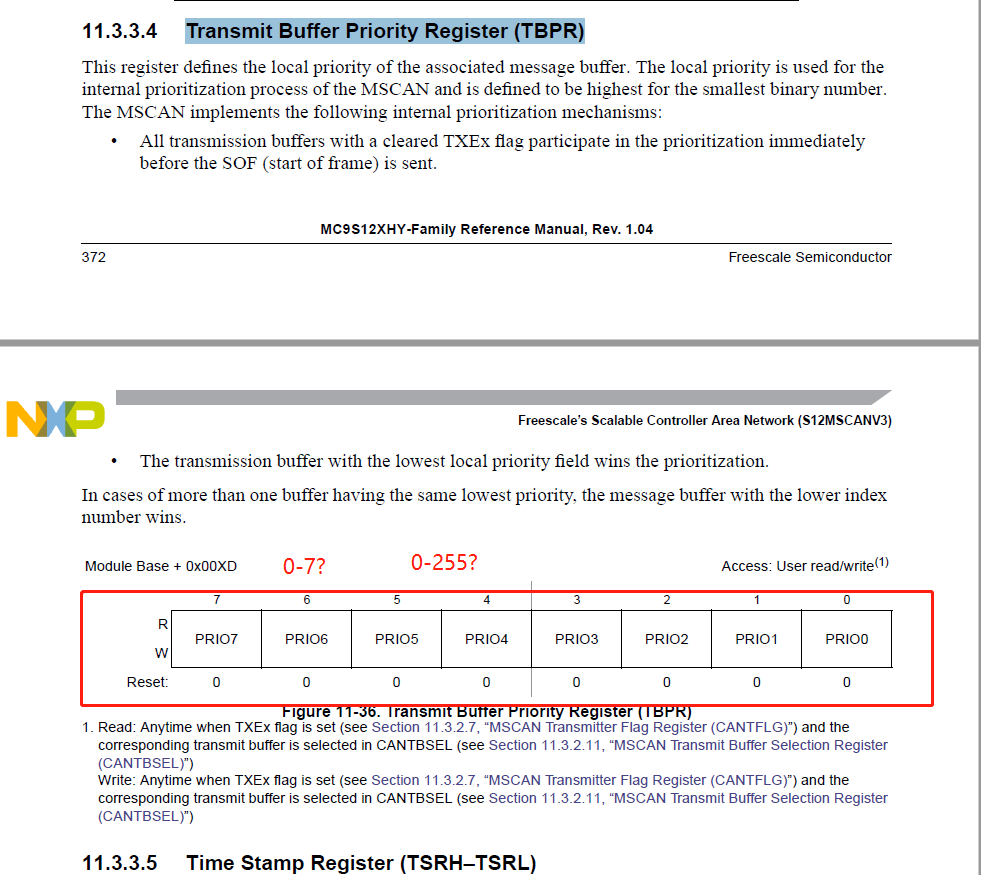

I dont understand about Transmit Buffer Priority Register (TBPR),this doc figure that binary number.
1,366 Views
lama
0~255.
