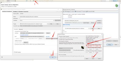

Hello ,you need to set "preserve range". If you did not set this parameters,it will erase all sectors while flash programming the chip。
