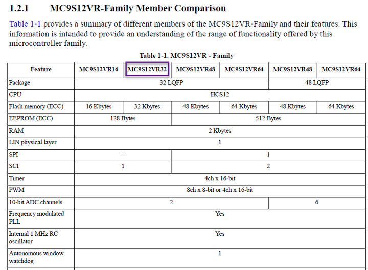

一、9s12vr   3c0n59h  型的芯片有人使用过吗?这个芯片的内存不知道是多大的?

Hello @kaimi,
By "9s12vr 3c0n59h", I think you mean S12VR32 mask 0N59H.
You can find the information in the S12VR datasheet.
https://www.nxp.com/webapp/Download?colCode=MC9S12VRRM
Regarding CW5.2, please follow this document:
https://community.nxp.com/t5/Classic-Legacy-CodeWarrior/How-to-Add-missing-derivatives-to-CodeWarrio...
