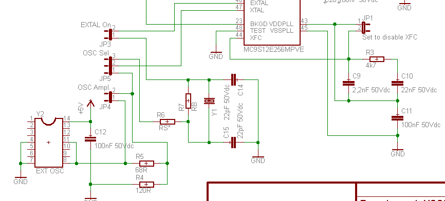

Now I am trying to determine the Busclock with an Frequency Counter. Pin PE7 is tied to ground (Pierce Oscillator 16Mhz 2pcs. 22pF).
Everything I am trying Ends up with a 137khz Busclock and I dont know how to fix it.
This is my schematic:
Can anyone help me out? I would like to have a 8Mhz or 16 Mhz busclock.
-Ingo

lama
the PLL components you use are the most suitable for PLL setup with Synr=refdv=10 when you want to make 16MHz busclk from a S12 MHz oscclk. I suppose you have used correct load capacitance for used oscillator.
E256 : input pin capacitance for pins XTAL, EXTAL     C1i = C2i = 7pF = Ci
Let C3=C4 = Ce
CLoad = (Ci + Ce)/2 and it has to be >= CLoad = 10 pF                        Cload is taken from a datashett for given oscillator, in this example 10pF
Then:
(Ci + Ce)/2  >= CL =>  Ce >= CL*2  - Ci
Ce >= 10pF * 2 - 7pF
Ce >= 13 pF
Rb value is from the interval 100kohm ~ 20Mohm. For low frequency circuits is crystal impedance relatively high and Rb should be high Rb = 10Mohm. For high frequencies (>20Mhz) Rb = 100 kohm.
Rs for high frequencies (>4MHz) can be omitted.
Moreover I suppose that you have only 100nF capacitors between Vdd and Vss because some customers connected Vdd to 5V which is mistake. May I see entire environment of the MCU?
Simple example of PLL setup:
static void PLL_Init(void)
CLKSEL &= 0x7F;   // set BUS CLOCK 16MHz from 16MHz MHz OSCCLK
REFDV = 0;
SYNR  = 0;
while(!(CRGFLG_LOCK));
CLKSEL_PLLSEL = 1;
PEAR_NECLK = 0;                   // make BUSCLK visible at PE4 pin
Have you measure frequency at oscillator to be sure it is working?
I hope you do not have any wire nor ground plane under oscillator circuitry. It can affect the oscillator in the way it is not working.
I would like to ask you, in the future, to create a new question at community if it does not corresponds to previous question.
Best regrads,
Ladislav
