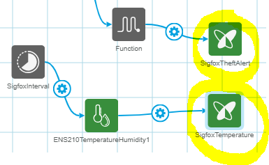

Is it possible to have two (or even more) SigFox Click elements in one project? I want to have one to perform periodical tasks and the secon one to be triggered ad hoc (in the case of alert/warning). It is possible to place two SigFox Click elements into NXP Rapid IoT view in the Studio:
Neverteless SigFox Click element is a coupled element with Cloud view. And there is my issue - Only the first instance of SigFox Click element placed to te NXP Rapid IoT view has its mirror created in Cloud view. Does it mean I need to use this element only once?

Hi Vilem,
Yes, but you could connect the same element to your 2 tasks that you have. You can achieve this using only one.
Mario
