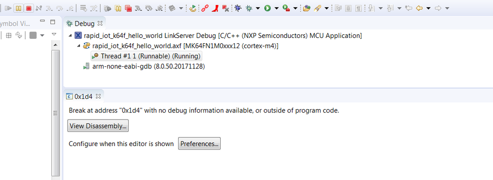

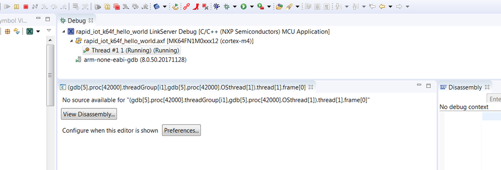

Hi All,
I tried to run "Hello World" project, after the download debug session not started. It was showing like below
Also SW3/SW2 + RESET also did not works

This issue is resolved by flashing kboot_k64f from SDK
Link -> SLN-RPK-NODE-SDK\SDK_2.3.0_RapidIoT_MK64F12\boards\rpk_k64f\rapid_iot_apps\kboot
