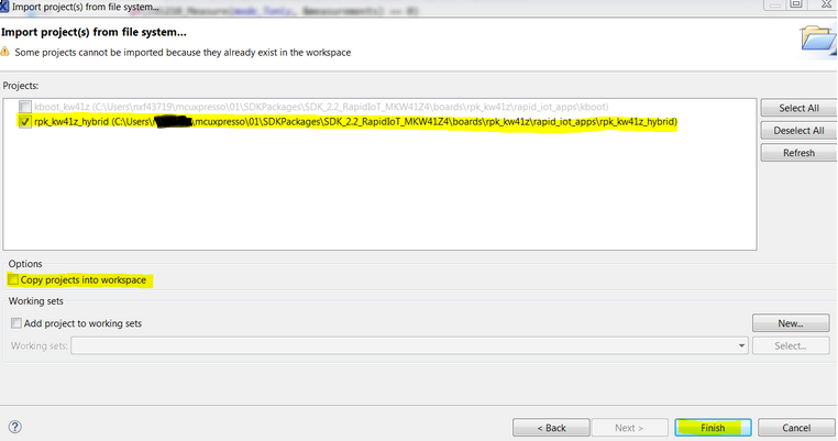

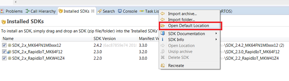

Moreover, in order to import the KW41Z application, please import from file system the project located under your MCUXpresso SDK path (see pictures below):
- Right-click in the Installed SDKs perspective
- Open Default Location
Then the source code is located under SDK_2.2_RapidIoT_MKW41Z4\boards\rpk_kw41z\rapid_iot_apps\rpk_kw41z_hybrid.
Make sure to untick "Copy projects into workspace" option.
