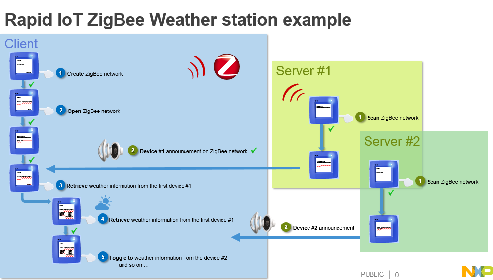

Please find attached to this post an example of ZigBee running on 2 (or more) Rapid IoT kits allowing to transfer data from one to the other over ZigBee.
The zipped package contains:
- A user guide explaining how to run the demo step by step
- The binaries required to flash the demo wo compiling code
- The binaries needed to rever back the Rapid IoT kit to factory mode
- The demo code so you can rapidly adapt it to your needs
- A SDK library needed to modify and recompile code when needed

Attached is a graphical view of how ZigBee is enabled- nice work Bruno Lemesle ! More details in the User Guide
