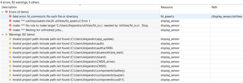

I have downloaded the examples. But when compiling I get the error that many of the libraries are missing. The libraries seem to be in the kit original SDK, but somehow they are not imported by MCUXpresso when creating the project. What can be done to solve this ?
Thank you.
Best,
Alejandro
To have a better tracking of this and better communication could you please post it in a new thread ?
Estephania
