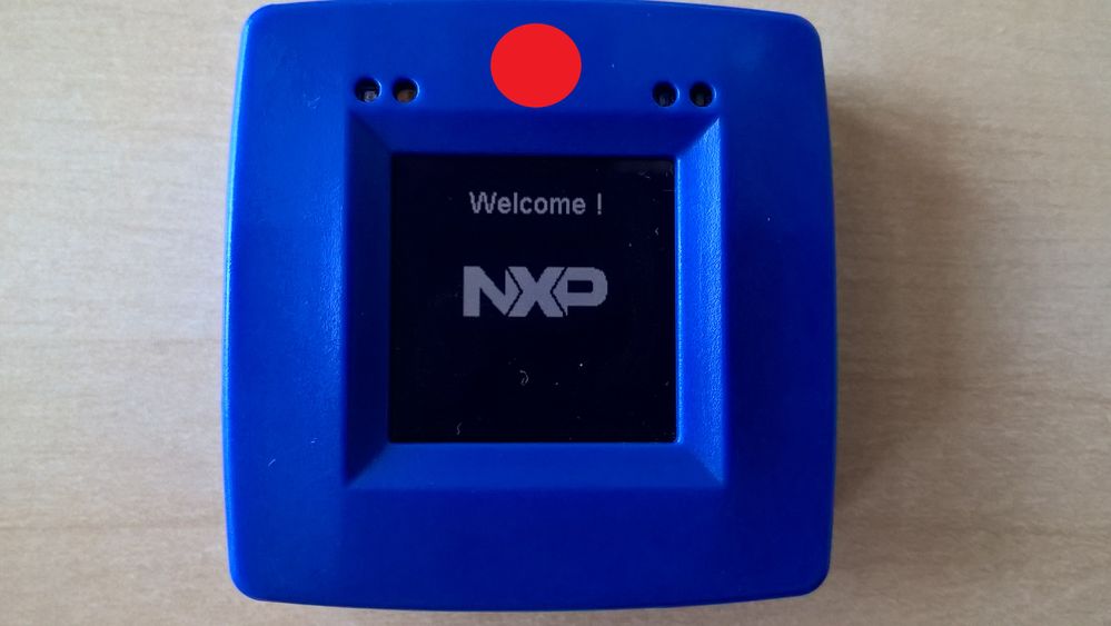

This example demonstrates how to use basic multi-task features in order to handle a multi-screen environment application.
In this example you will find three screens:
Welcome Screen
(T3 / Top Touch)
Temperature screen
(T2 / Right Touch)
WP_20181102_14_22_21_Pro.jpgHumidity screen
(T4 / Left Touch)
Four tasks are created :
  • UiManager task: Handle touch buttons event and screen transitions
  • Main screen task: Display the main screen
  • Temperature screen task: Display the temperature measurements from ENS210 sensor
  • Humidity screen task: Display the humidity measurements from ENS210 sensor
  • + mutex-semaphore is implemented to handle shared resources between tasks (Display & sensors)
Screens are described in an object-oriented manner to easily manage them in the task's code:
.navigation describe how the menu transition will behave
.title & .image will be used to display correct information
.start/stopTaskFunction will be used to create/pause the according measurement&display task.
