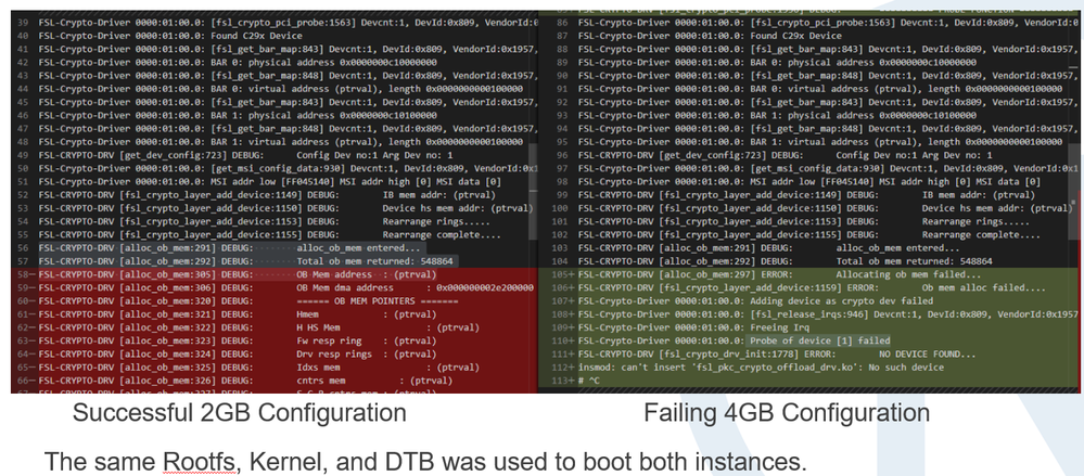

cordong2956
  • Using Kernel 5.1.9
  • dma_alloc_coherent() call works as expected when total system memory is 2GB / 3GB
The call is used within Kernel PCI Driver within the code snippet below:
  • int32_t alloc_ob_mem(fsl_crypto_dev_t*dev, struct crypto_dev_config*config)
    void *
    host_v_addr;
    struct pci_bar_info*mem;
    uint32_t
    ob_mem_len;
  • /* First get the total obmem required */
    ob_mem_len= calc_ob_mem_len(dev, config);
    mem = &(dev->
    priv_dev->bars[MEM_TYPE_DRIVER]);
  • print_debug("alloc_ob_mementered...\n");
    print_debug("Total obmem returned: %d\n", ob_mem_len);
  • host_v_addr= dma_alloc_coherent(&dev->priv_dev->dev->dev, ob_mem_len,
    &(mem->
    host_dma_addr), GFP_KERNEL);
    if (!
    host_v_addr)
  • { print_error("Allocating obmem failed...\n"); return -ENOMEM; }
Log of failure:

My main questions from this are:
-  Is there specific kernel configuration or any kernel drivers necessary to allow the dma_alloc_coherent() call
to successfully work past the 32 bit addressing ?
If any more details are required please let me know so that I can provide them.
Thanks in advance!

FSL-CRYPTO-DRV [alloc_ob_mem:291] DEBUG: alloc_ob_mem entered...
FSL-CRYPTO-DRV [alloc_ob_mem:292] DEBUG: Total ob mem returned: 548864
FSL-CRYPTO-DRV [alloc_ob_mem:296] ERROR: mydev: 24-bit DMA addressing not available
FSL-CRYPTO-DRV [alloc_ob_mem:302] ERROR: Allocating ob mem failed...
FSL-CRYPTO-DRV [fsl_crypto_layer_add_device:1164] ERROR: Ob mem alloc failed....
FSL-Crypto-Driver 0000:01:00.0: Adding device as crypto dev failed
FSL-Crypto-Driver 0000:01:00.0: [fsl_release_irqs:948] Devcnt:1, DevId:0x809, VendorId:0x1957, Bus:1
FSL-Crypto-Driver 0000:01:00.0: Freeing Irq
FSL-Crypto-Driver 0000:01:00.0: Probe of device [1] failed
FSL-CRYPTO-DRV [fsl_crypto_drv_init:1780] ERROR: NO DEVICE FOUND...
insmod: ERROR: could not insert module ./lib/modules/5.1.9/extra/fsl_pkc_crypto_offload_drv.ko: No such device

Thanks in advance!
