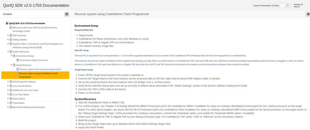

I just found out in the SDK documentation a system recovery section:
Will this help me what I'm trying to achieve ? If yes, would I be able to directly install on my board the files generated through SDK 2.0 v1703 with CodeWarrior?
Filip
3,491 Views
ufedor
In general your understanding is correct, but in the specific case there is more straightforward way when complete NOR Flash image is programmed by means of the CodeWarrior Flash Programmer.
The image is available on the QorIQ Linux SDK v2.0 CORTEXA7 IMAGE.iso:
\flash-image\QorIQ_SDK_V2.0_LS1021ATWR_20160527_NOR_Flash.bin
The ISO can be downloaded from the same place as the SDK v2.0.
