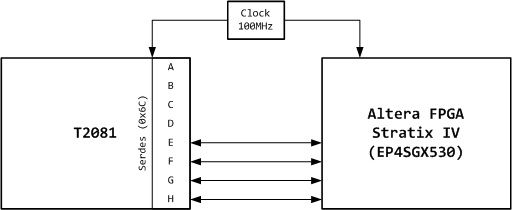

Hi All,
I am using the T2081 board made.
PCIex4 lanes of the T2081 has confirmed that the recognition by connecting to Altera FPGA.
* boot log
PCIe4: Root Complex, x4 gen1, regs @ 0xfe270000
  01:00.0     - 1172:0004 - Does not fit any class
PCI host bridge /pcie@ffe270000  ranges:
MEM 0x0000000c40000000..0x0000000c4fffffff -> 0x00000000e0000000
  IO 0x0000000ff8030000..0x0000000ff803ffff -> 0x0000000000000000
# lspci
00:00.0 Class 0604: 1957:0839
01:00.0 Class ff00: 1172:0004 <-- Altera FPGA
# cat /proc/iomem
00000000-ffffffff : System RAM
c40000000-c4fffffff : /pcie@ffe270000
  c40000000-c4fffffff : PCI Bus 0000:01
    c40000000-c400003ff : 0000:01:00.0
    c40000400-c400007ff : 0000:01:00.0
    c40000800-c40000bff : 0000:01:00.0
fe8000000-fefffffff : fe8000000.nor
Use the mmap64 receive an error as shown in Table 1, we read the 0xc40000000 address.

tiagobrusamarel
Contributor V
Hello bpe.
I'm having the same issue that gyosun is having. I'm getting the Machine Check exception when trying to read from PCIe4 I/O address space.
We have 2 custom CPU boards with QorIQ processors: one with the T2081 and another with the T1022. For the application we have a custom base board with the PCIe (x1 Gen2) link partner connected to SerDes lane E.
When using the T1022 CPU board I can communicate with the link partner normally. But with the T2081 I'm getting the Machine Check exception all the time.
The kernel driver for that is basically the same, with the difference that the T1022 runs in 32 bit mode and the T2081 in 64bit mode.
Please find attached the register's dump generated from the Corewarrior Debugger at the moment of the failure.
Could you please help me find out whats is wrong?
Tiago.
3,458 Views
tiagobrusamarel
Contributor V
Hello again.
I found out what was the cause of my problems with PCIe4: I was using wrong memory ranges for PCIe device nodes on our board DTS file. After copying the memory ranges defined for the T2080RDB board the problem was solved.
3,458 Views
gyosunshim
Hello Tiago,
Be glad to solve the problem. I 's still a problem.
What, and Where is the DTS?
How can you explain in detail that you solve the problem?
PCIe is connected to four lanes, as shown below.
Gyosun.
