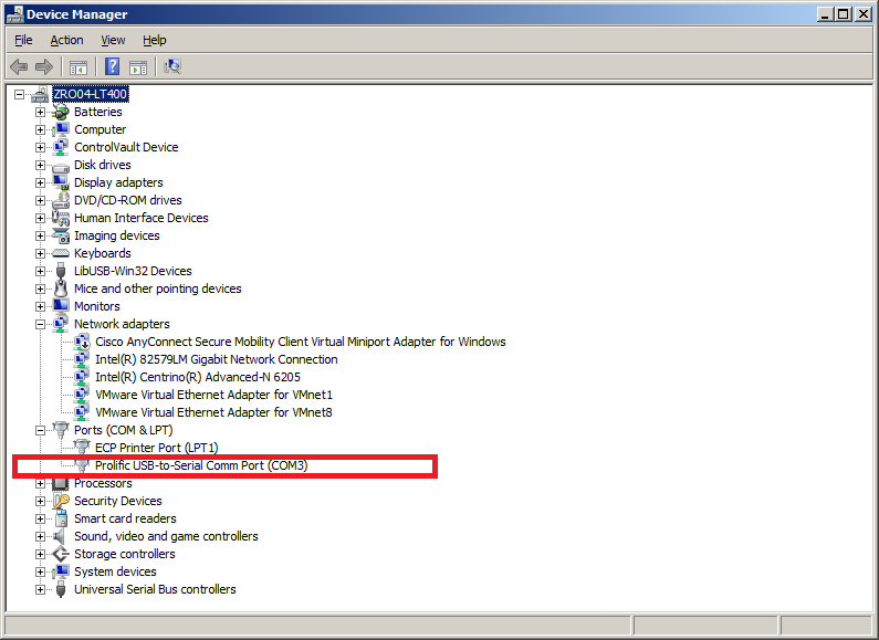

I am using the TWR-P1025: QorIQ P1 MPU Tower System Module. I would like to read in an RS422 data stream, which has been converted to USB. Would it be possible to read this in on the USB Mini B, UART Serial Interface? I am expecting a data rate of 64kbytes (or 524288 baud), so will this baud rate be too high?

marius_grigoras
I think this should work. Just select correctly the COM port (you can see the mapping in Device manager).UsbtoSerial.png
Can you tell me please how you calculated this baudrate? For example, both CodeWarrior and u-boot are using 115200 baudrate.
Marius

drs
Hi Marius,
Thanks for your reply. I have to read in an external data stream, which has been specified by a colleague as 524388 baud (64k bytes per second). The data steam is RS422 data, which is converted to USB. The intention is to plug this in to the USB Mini B, UART Serial Interface and then read the data from the port in software on the P1025 board. The data does not have to be echoed to the terminal window, so I am hoping that the 115200 baud rate limit will not apply.
