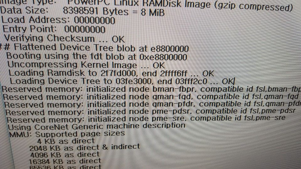

We are trying to secure boot using T2080RDB-PC.
But it still didn't work.
We have trouble in file system mount.
I attached two pictures.
First is normal boot log and second is secure boot .
There are "Loading Ramdisk to 2f8fd000, end 2ffff6ff ..OK" in the normal boot, but there are no message about ramdisk in secure boot log.
Could you let us know the reason we can't mount file system ??
Is it related to message that"Loading Ramdisk ~~~" ?

Hello yangjae lee,
In Secure boot, you need to deploy your rootfs filesystem at 0xE9300000 and the size should less than 29696K.
In secure boot bootscript, you need to use 0xE9300000 in the bootm command, and boot rootfs from NOR flash directly.
