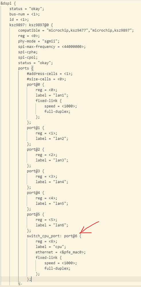

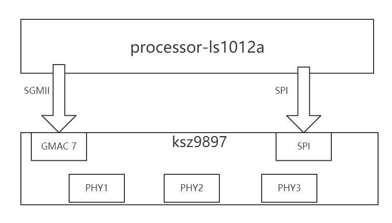

I am using ls1012a on my hardware, also I am using ksz9477 ethernet switch connecting to PFE
                                                                        Figure 1: KSZ9897S
Because ksz9897 doesn't support MDIO, so I am using the SPI instead of MDIO. see below.
I can see eth0 and eth1 when the board is powered onAlso, I can configure eth0 with static ip. But I cannot ping external devices at all. I assume the problem happens on the connection of MAC and PHY. The driver spi-fsl-dspi.ko is not used by any other modules. I think the problem is caused by my device tree configuration.

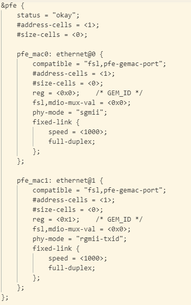

I configured my device tree as below:
                                                                                        Figure 3: PFE node
                                                                             Figure 4: SPI node
port@6   (i.eGMAC7) in the device tree is used as the MAC port connecting to PFE via SGMII.

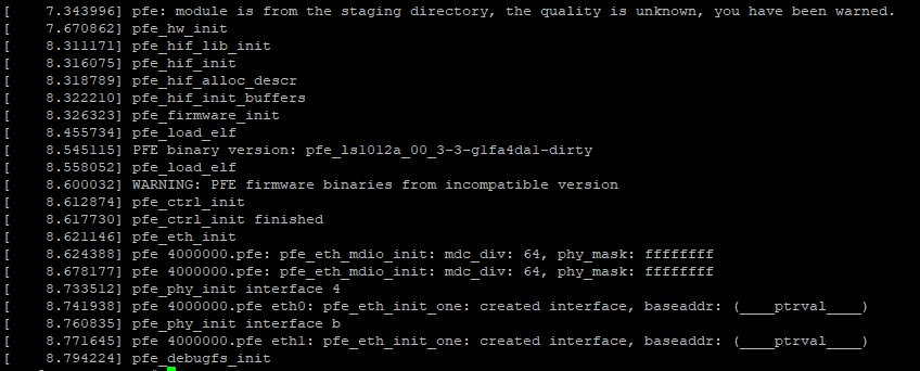

the output of demsg about PFE is show as below

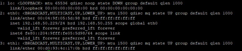

Also, I can see both eth0 and eth1, but I am only using eth0 and I can configure the eth0 with static ip.

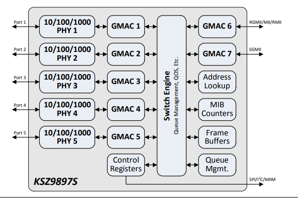

The KSZ9897S switch supports MIIM (MDIO).
See the KSZ9897S Datasheet.
See the LED4_1, LED3_1 setting.
Use this interface for connection.
