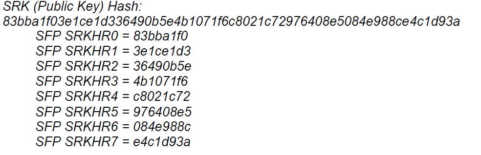

#Wrie the SRK Hash Value in Mirror Registers
ccs::write_mem 0 0xfe0e807c 4 0 <SRKH1>
ccs::write_mem 0 0xfe0e8080 4 0 <SRKH2>
ccs::write_mem 0 0xfe0e8084 4 0 <SRKH3>
ccs::write_mem 0 0xfe0e8088 4 0 <SRKH4>
ccs::write_mem 0 0xfe0e808c 4 0 <SRKH5>
ccs::write_mem 0 0xfe0e8090 4 0 <SRKH6>
ccs::write_mem 0 0xfe0e8094 4 0 <SRKH7>
ccs::write_mem 0 0xfe0e8098 4 0 <SRKH8>

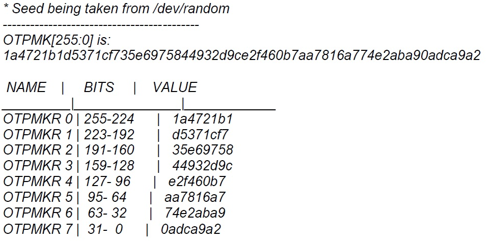

I am seeing a mention of running the OTPMK Hamming algorithm on the OTPMK hash. Is that necessary?
Can the OTPMK hash be obtained the same way as the SRKHR?
I am suing the provide uni_sign tool to get the SRKHR hash, can it be used for the OTPMK hash?
Also, is the OTPMK hash need to be byte swapped? From the Setting up Secure boot document, the way that OTPMK hash is listed is a bit different from the SRKHR (which has no mention of bit order).

Blow OTPMK to fuse array is necessary to enable secure boot.
Generate OTPMK key with CST command gen_otpmk_drbg, please refer to the following.
./gen_otpmk_drbg <bit_order> [string]
<bit_order> : (1 or 2) OTPMK Bit Ordering Scheme in SFP
1 : BSC913x, P1010, P3, P4, P5, C29x
2 : T1, T2, T4, B4, LSx
<string> : 32 byte string
No need to do swapping for the generate OTPMK key.

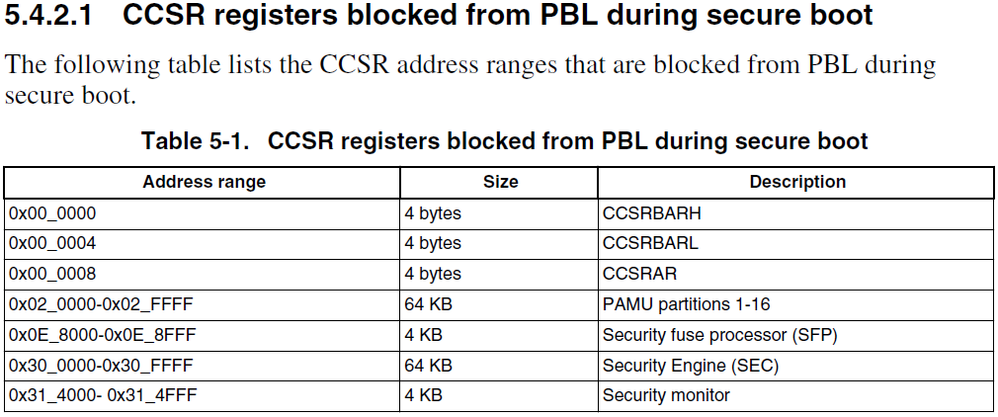

Also, in the "Setting up Secure Boot on PBL Based Platforms in Prototype Stage", there is a section to write the keys hash in ccs. However, the QorIQ P5020 Reference Manual 5.4.2.1, said that those register are blocked during secure boot.
I did try to write to the 0xe_805c and confirmed that the write did not go successfully.
Did I miss something?
