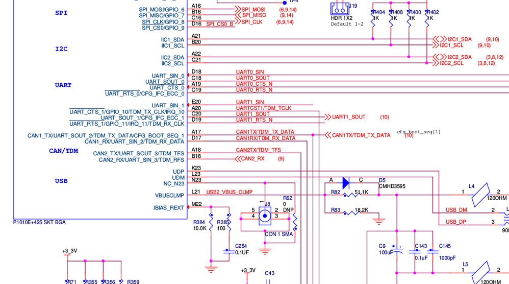

nobelsharanyanj
Hi Scott,
Yes, now it is showing up in reference board.
Above image is the schematic of the reference board - P1010RDB-PB.
I am curious to know, When I am using GPIO_6 i did pin muxing to support GPIO_6 as the pin by default it is SPI_MOSI.
where us in this case, I am trying to use UART_SIN_1 and UART_SOUT_1 without hardware flow control (RTS and CTS).
By default the pin should be UART_SIN_1 and UART_SOUT_1, why there is a need of pin muxing here.
Nobel
