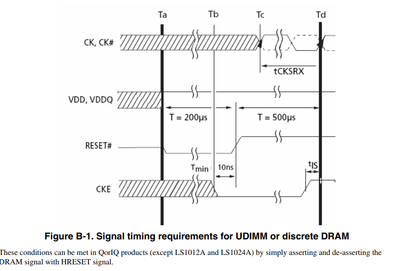

Are the signals below OK?
Referring to the documentation of AN5097, the CKE signal should go HIGH after the RESET signal, but it doesn't seem to be the case.
In the case of the same DDR clock, the signal looks small.
Can you give us your opinion?

1) JTAG connection circuit is implemented exactly as shown in the AN5407 - Layerscape LX2160A and LX2162A Design Checklist, Figure 36. JTAG interface connection.
2) Reset to SDRAM devices is implemented as proposed in the AN5097 - Hardware and Layout Design Considerations for DDR4 SDRAM, Appendix B DRAM reset signal considerations.
Please provide a digital scope trace showing behaviour of PORESET_B, HRESET_B and SDRAM reset signals.

We fixed a reset related issue. Then, we successfully performed validation and confirmed that there was no fail. However, I created an expert code and applied it to the source, but ddr does not work normally.
When performing clock validation, we saw that appropriate clock delay values were selected in write leveling and read gate training. What register is this value stored in? We can't see the relevant value in the generated ddr_init.c. For ls1046, wrlvl control register exists - (DDR1_DDR_WRLVL_CNTL/2/3) . However, it does not exist on the lx2160a. If the lx2160a doesn't support it, this test seems meaningless. What should we do? Looking forward to your reply. thank you
