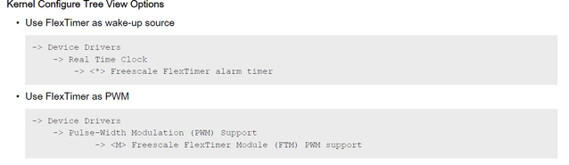

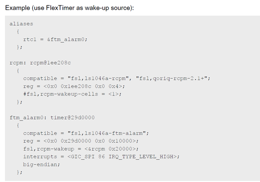

yipingwang
FlexTimer (FTM)  can provide functions, such as PWM, clock source, wake-up source. Currently, only wake-up source and PWM are supported on Layerscape platforms.

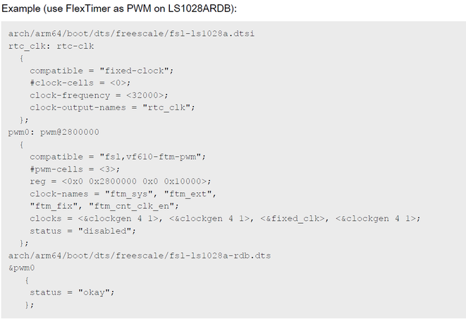

zhujianbin
The configuration you post is PWM, not input capture.
I am currently implementing the ko for input capture.
