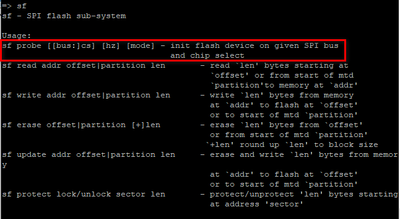

1. According to the instruction of sf probe in U-BOOT, the speed of QSPI flash can be set in the third argument.
Command is sf probe 0:0 20000000

I have two questions below need to clarify.
  1. How to modified the QPSI clock?
  2. How to successfully read/write QSPI FLASH in SD boot?
