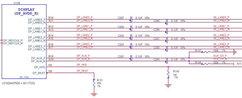

Hello
According to document AN12028 "QorIQ LS1028A Design Checklist" pins DP_AUX_P/DP_AUX_N should be decoupled with 100nf and should be pulled up/down.
Here my question:
Where should the resistors be located, behind or before the capacitors?
Thanks in advance for your support
