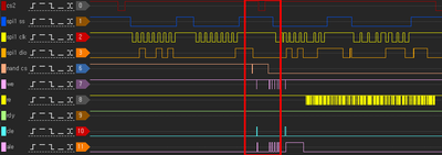

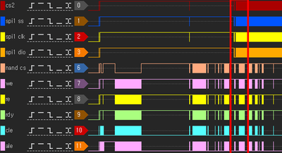

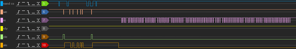

This is a review of NAND Flash pins with a logic analyzer.
If SPI_SS2_N (AD23) and GPIOa (H4) are not used, the picture below will appear.
If SPI_SS2_N (AD23) and GPIOa (H4)  used, it will come out the same as the picture below.
In particular, the reason why NAND_CS does not fall low seems to be the cause.
What should I do to solve this?
Please tell me what causes the other pins to affect NAND_CS.

It could be a wrong configuration of the Expansion Bus Interface, there are some rules to follow when used as NAND Mode that is relevant for CS4 only, chip select #4 is used as the NAND write enable signal (Exp_nand_we_n).It is not supported by the chip selects #0-3,  please review the configuration and the block functional description, the expansion controller provides the flash address/data/command and drives the NAND_WE#\NAND_RE# signals.
3,998件の閲覧回数
Oswalag
I understand that if SPI_SS2_N (AD23) and GPIOa (H4) are not used ECC is not output, my question is what happen if you try these 2 scenarios below:
1) SPI_SS2_N (AD23) Used and GPIOa (H4) not used.
2) SPI_SS2_N (AD23) not used and GPIOa (H4) used.
these in order to see if the issue occurs only when one of the signals is used or always with both.
could you also share the complete picture of all the signals when ECC comes out from NAND with the name according to the datasheet.
3,993件の閲覧回数
h201668
1) SPI_SS2_N (AD23) enabled and GPIOa (H4) disabled.
=> AD23 pin and H4 must be used at the same time. 2 pins are used to transmit SPI signals.
The AD23 pin is used as the SPI clock, and the H4 pin transmits and receives the SPI DIO signal. Use the SPI_SS1_n (AE23) pin as SPI1_cs.
2) SPI_SS2_N (AD23) is not used and GPIOa (H4) is used.
=> Same as above answer.
This is to determine if the problem only occurs when one of the signals is used, or if the problem always occurs with both.
Can you share a full picture of all the signals when ECC comes from NAND with the names according to the datasheet?
=> It doesn't look like SPI signal control will affect NAND_CS, but please check the attached picture.
Add
1. Booting and system operation pictures
2. Use with SPI1_ss and SPI_DIO
3. Causes of NAND_CS_n ECC
1) Enlarge photo
1-1) Enlarge photo
My thoughts do not seem to be related in SPI1_CLK(AD23) and SPI1_DIO(H4), but I need to check if CS2 and NAND_CS are related.
The reason why I think it is the cause of ECC is that NAND_CS became active low and then recognized it as high.
I have confirmed that ECC is not output unless CS2 is used.
What do you think about this part?
I look forward to your reply.
4,066件の閲覧回数
Oswalag
spi_ss2_n when is used as GPIO it is GPIO 21 that is muxed with other functional pin and can only be used in case the
other functionality is not used, on the other hand GPIO15 - SPI_SS2_N(AD23)  is a dedicated general purpose I/O interface signals for specific control, monitoring signaling purpose, if you don't use SPI_SS2_N(AD23) the issue continues?
4,051件の閲覧回数
h201668
Thank you for answer
Is the GPIO 21 you told us about SPI_SS2_n correct?
Otherwise, it is necessary to check whether GPIO15 is SPI_SS2_n.
It does not use GPIO15.
However, the AD23 pin is used.
AD23 pin becomes GPIO 21.
Hope you can check again.
And AD23 pin must be used, and clk is made and used with GPIO21.
