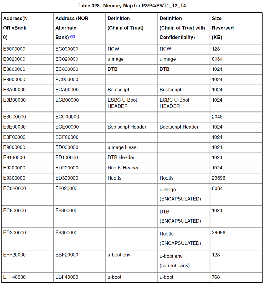

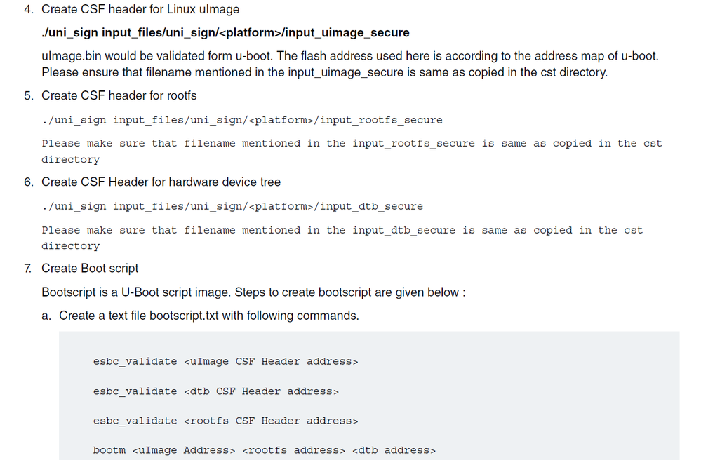

Sorry for asking similar questions, but it still didn't work  :,(
We asked about root file system mount again.
Last question, we got the answer that bootm command contains incorrect address for root file system.
Out bootscript is as follows:
  bootscript
we refer to SDK. and normal booting works well.
So we think that u-boot-secure-boot has problem. is this right?? answer PLZ
If u-boot-secure-boot has problem, we have to change u-boot-secure-boot.
In this process, do we have to change secure u-boot based on sdk u-boot source code? or can secure u-boot changed based on u-boot of DENX?
When we change secure u-boot, do we have to change secure u-boot based on sdk u-boot source code? Or can secure u-boot changed based on u-boot of DENX?
=> pri
baudrate=115200
bdev=sda3
bootcmd=setenv bs_hdraddr 0xe8e00000;setenv bootargs 'root=/dev/ram rw console=ttyS0,115200 ramdisk_size=600000';esbc_validate $bs_hdraddr;source $img_addr;esbc_halt
bootdelay=0
bootfile=uImage
consoledev=ttyS0
ethact=FM1@DTSEC3
ethprime=FM1@DTSEC3
fdtaddr=1e00000
fdtfile=t2080rdb/t2080rdb.dtb
fman_ucode=eff00000
hwconfig=fsl_ddr:ctlr_intlv=cacheline,bank_intlv=auto;usb1:dr_mode=host,phy_type=utmi
initrd_high=0xffffffff
loadaddr=1000000
netdev=eth0
nfsboot=setenv bootargs root=/dev/nfs rw nfsroot=$serverip:$rootpath ip=$ipaddr:$serverip:$gatewayip:$netmask:$hostname:$netdev:off console=$consoledev,$baudrate $othbr
ramboot=setenv bootargs root=/dev/ram rw console=$consoledev,$baudrate $othbootargs;tftp $ramdiskaddr $ramdiskfile;tftp $loadaddr $bootfile;tftp $fdtaddr $fdtfile;bootr
ramdiskaddr=2000000
ramdiskfile=t2080rdb/ramdisk.uboot
rootpath=/opt/nfsroot
stderr=serial
stdin=serial
stdout=serial
tftpflash=tftpboot $loadaddr $uboot && protect off $ubootaddr +$filesize && erase $ubootaddr +$filesize && cp.b $loadaddr $ubootaddr $filesize && protect on $ubootaddre
uboot="u-boot.bin"
ubootaddr=0xeff40000
Environment size: 1360/8188 bytes

Hit any key to stop autoboot: 0
esbc_validate command successful
## Executing script at e8a00000
uImage validate start
uImage validate end
dtb validate start
dtb validate end
rootfs validate start
rootfs validate end
WARNING: adjusting available memory to 30000000
## Booting kernel from Legacy Image at e8020000 ...
Image Name: Linux-4.1.35-rt41
Image Type: PowerPC Linux Kernel Image (gzip compressed)
Data Size: 5106036 Bytes = 4.9 MiB
Load Address: 00000000
Entry Point: 00000000
Verifying Checksum ... OK
## Loading init Ramdisk from Legacy Image at e9300000 ...
Image Name: fsl-image-core-t2080rdb-20180820
Image Type: PowerPC Linux RAMDisk Image (gzip compressed)
Data Size: 33049619 Bytes = 31.5 MiB
## Flattened Device Tree blob at e8800000
Booting using the fdt blob at 0xe8800000
Uncompressing Kernel Image ... OK

This is our secure-boot log.
3,495 Views
yipingwang
Hello yangjae lee,
Please use the pre_built images provided in QorIQ-SDK-V2.0-PPCE6500-IMAGE-20160527-yocto.iso which could be downloaded from NXP public Website.
Please refer to the following procedure to sign images and create the boot script.
Please refer to the following NOR flash memory map for T2080RDB.
TIC
3,495 Views
leelambjae
Yiping Wang.
We use 201601(64bit) ver in QorIQ-SDK-V2.0-PPCE6500-IMAGE-20160527-yocto.iso.
Now but, booting is not work at all.
Can you help us?
3,495 Views
leelambjae
Yiping Wang.
Thank you for your answer.
We used pre-built image in QorIQ-SDK-V2.0-PPCE6500-IMAGE-20160527-yocto.iso.
Normal booting was work well, but secure boot didn't work yet. (in 64 bits environment)
In this picture, we got the message that "rootfs image is not initramfs (junk in compressed archieved)"
Could you tell us more specifically?
THANK YOU!
HAVE A GOOD DAY!!
