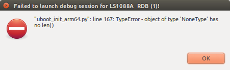

We loaded the qspi uboot.elf generated by flex-builder for ls1088ardb to CodeWarrior for ARMv8. However, upon debugging, we encounter the error as shown below. What could be the cause of this error? Thanks!
Setup Details:
Board: LS1088ARDB
CodeWarrior Warrior Development Studio for QorIQ LS Series - ARM V8 ISA: Version 11.3.0
Host: Ubuntu 16.04

carljones
So I figured that the uboot.elf was not the file that was supposed to be selected in CodeWarrior Executable Importer, it is supposed to be just the uboot (with out the extension name).
