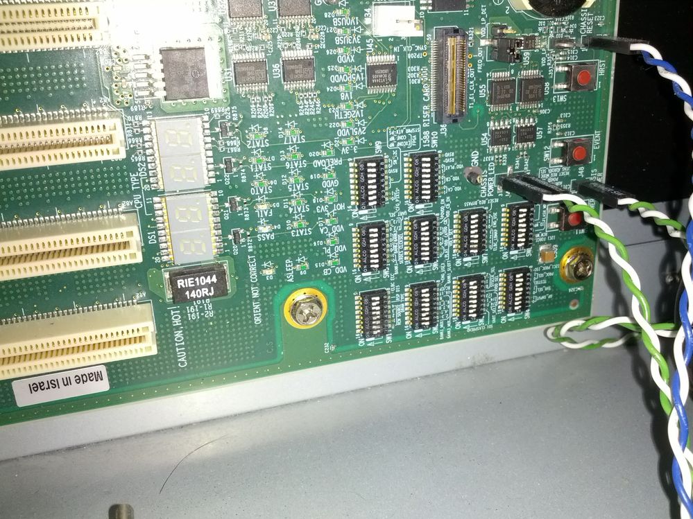

For the purposes of this article, I'll assume I've blown away everything in NOR flash (including the RCW). This will be a similar scenario to a blank board back from the factory. In this case, in order to connect with a debugger we'll need to set a hard coded RCW. From the P3041DS documentation, I see that DIP Switch SW1 configures the RCW_SRC

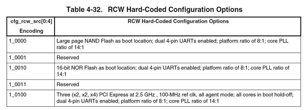

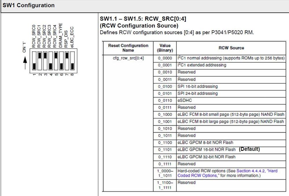

I need a hard coded RCW option, so I'll look through the P3041RM to find out what cfg_rcw_src should be set to.
From this, I determine that I want to set cfg_rcw_src = 1_0010, so I set SW1 on the DS appropriately.
Note that on the DS system, "ON" = '1'

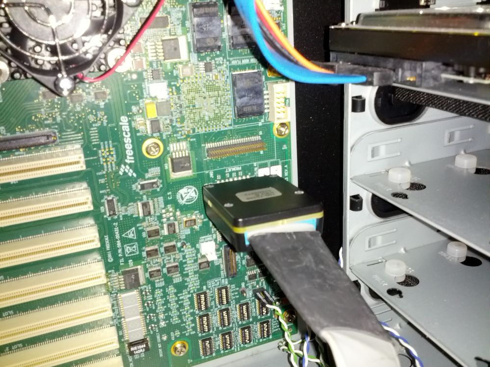

After reconfiguring SW1 to a hard coded RCW option, I plug in my Ethernet TAP probe tip into the COP header.
Note the pin1 location, and line up the probe tip appropriately.

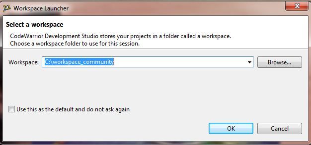

Now, it's time to fire up Codewarrior. Codewarrior is eclipse based. I won't go through a large eclipse tutorial - but I'll demonstrate some of the basics. One of the first things Codewarrior does, is ask you for a workspace location. A workspace is a containing folder for any projects you might have. In this case I created a new folder called workspace_community.
I'll create a new project for this. A project contains files I might compile and download to a bareboard, initialization scripts, and settings for how to connect to the board. Select FILE / NEW / Power Architecture Project

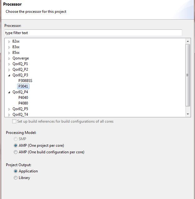

Next, select the appropriate processor

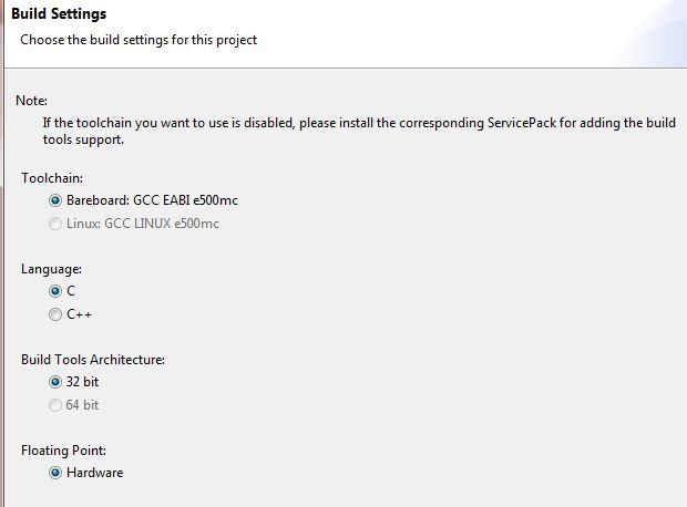

Build settings would be used typically for building code, in my case it's really a don't care.

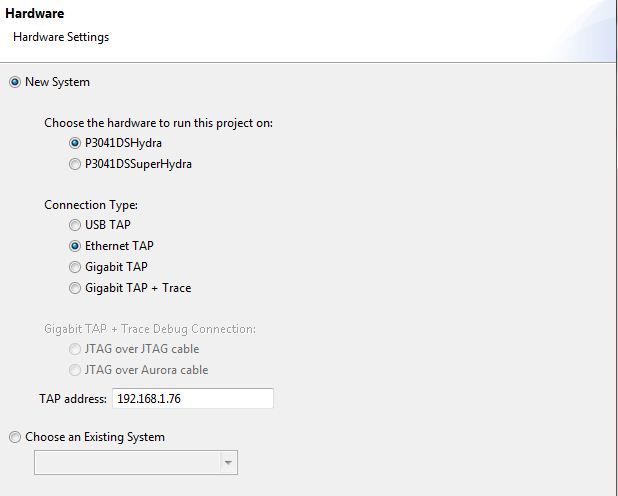

I'm only using Core0, so I press NEXT, and then finally I select my TAP connection. In my case, I'm using an Ethernet TAP with IP address 192.168.1.76

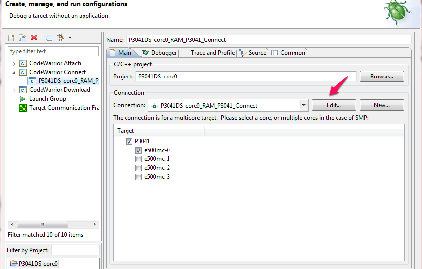

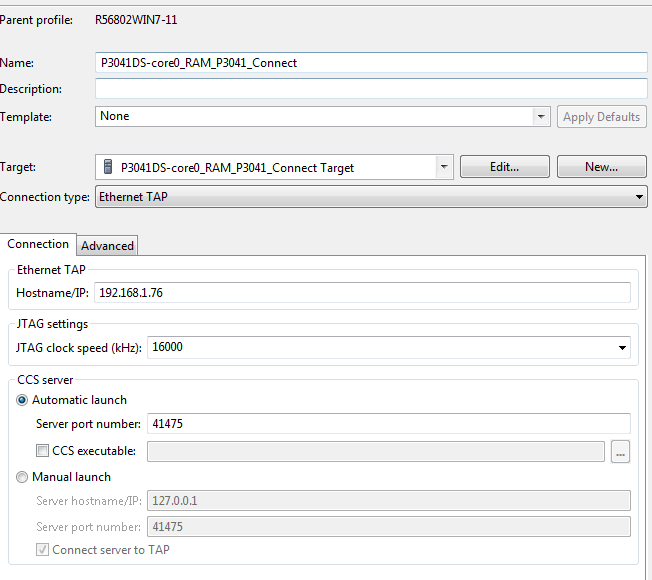

I'm going to use Codewarrior Connect, and I'll select that option for my project. To configure my connection, I can select Edit, next to the connection.
Here I see my connection type is Ethernet TAP with the correct IP address, as I previously selected in the new project wizard.

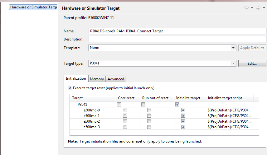

If I wanted to change my initialization script I would select Edit, next to the Target.
This brings up a screen with options for connecting to the specific target. You have the option to reset the core, or not, as well as the option to initialize the target with a script. The default scripts can be used as a reference for a custom board. They initialize parameters such as DDR, MMU, local bus in order for the debugger to gain access to these peripherals. Again, I won't go into details. There is Codewarrior documentation included in the installation, typically found within the C:\Program Files\Freescale\CW PA v10.xx\PA\Help\PDF directory.
In this case, I am using the standard P3041DS system, and will just go back to the main debug "Debug Configurations" screen and click debug. This will initiate a connection to the target via the Ethernet TAP, and change the eclipse prospective to the debugging prospective.

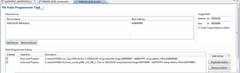

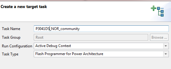

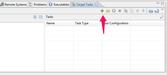

The codewarrior flash burner is run through target tasks in Codewarrior 10.x. A target task defines the flash interface, addresses and images to be burned. Within to target task view, click on the green plus icon to add a target task.
This will bring up a window where we can name the task. Task type should be flash programmer. The Hardware Diagnostic task type is useful for running memory tests, but that is discussed in the Codewarrior documentation. Run Configuration describes how we connect to the board. Since I am already connect to the target through a project, I select Active Debug Context.

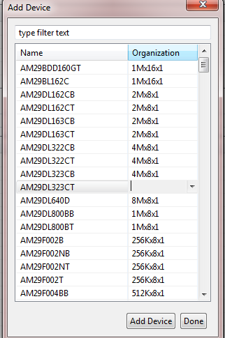

A view should show corresponding to the task created. At this point, we need to add the flash device. YThe flash base address is ou can change the organization by clicking to the right of the organization within the Add Device window. This will show a pull down menu with the various organizations.
Base address is configured through the initialization script. By default this is set to 0xE8000000. Target RAM defines a buffer on the target for the algorithm to use. And towards the bottom of the view, one can add Flash Programmer Actions, which describe what is to be done. Examples include erase, or progam a file. It's possible to set up multiple actions, such as erase the entire flash, program the RCW, FMC uCode and Uboot.

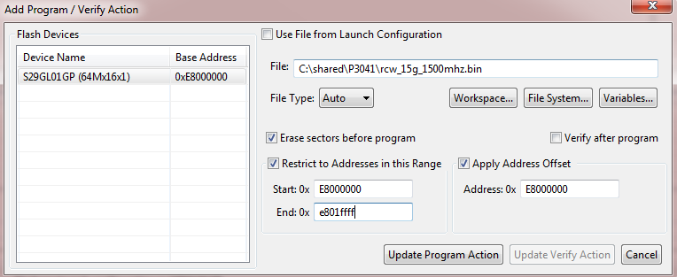

In this picture, I am adding an action to program the RCW, which is contained in a bin file, to location 0xe8000000. Since a binary has no offset, I need to apply address offset of 0xe8000000 to the file. I instruct it to erase sectors before programming as well, and restrict the actions to the sectors affected.
When I've added everything needed, be sure to save the target task. Below is a screenshot of my target task to update the RCW and Fman UCode.
I'll save it to the framework, which means it's part of the project.
Then, to run the flash programmer, simply click on the green "play" arrow in the target tasks view. The programmer should run and if sucessful, will print out a message in the Codewarrior flash programmer console.

1) You show in the document on how to flash rcw and fman ucode into the flash. So the process of flashing u-boot is also similar?
2) How do we debug u-boot (compiled in yocto environment) with code warrior and USB Tap? Is there any documentation on this process?
I am also interested in the flashing of u-boot. If there is it would be nice.
The u-boot at P3041DS must be written in the last 512KB of the NOR flash. Yes, the process is similar, just please use the start address from 0xeff80000.

I will make just a small specification about Flash Programmer routine. It's very simple to use the "already prepared" flash programmer target task instead of making some new ones.
Just right click and import the desired FP target task for your board. The best part with these provided target tasks comes from the fact that they are already built with all necessary flash devices and memory setups.

I am a hardware engineer and am confused by how to associate the cfg_rcw_scr(0:4) to the actual Hardware Signals. The confusion results in not being able to determine the most significant bit for the cfg_rcw_scr bits.
For your hard coded table shown above, Table 4-32, for a 1_0010 equating to cfg_rcw_src(0:4), what is the most significant bit, cfg_rcw_src[0] or cfg_rcw_src[4]?
For the LGPLx hardware signals shown below, it is ambiguous which is the msb when you write cfg_rcw_src(0:4) = 1_0010. Hardware convention suggests that the left most digit is the msb and it is cfg_rcw_src(0).
Cfg_rcw_src[0] = LGPL0
Cfg_rcw_src[1] = LGPL1
Cfg_rcw_src[2] = LGPL2
Cfg_rcw_src[3] = LGPL3
Cfg_rcw_src[4] = LGPL5
Can you clarify the ambiguity?
Bob
The bits (on Power Architecture, at least) are typically written MSB to LSB (left to right). So, in the case of cfg_rcw_src[0:4], crg_rcw_src0 is the MSB. This corresponds to LGPL0.
So, when writing cfg_rcw_src[0:4]=1_0010:
cfg_rcw_src0 = lgpl0 = 1
cfg_rcw_src1 = lgpl1 = 0
cfg_rcw_src2 = lgpl2 = 0
cfg_rcw_src3 = lgpl3 = 1
cfg_rcw_src4 = lgpl4 = 0
