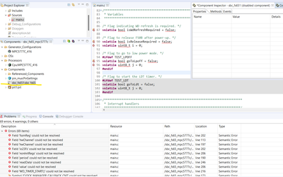

when i import SBC example from NXP for MPC5777c controller, IDE Says that  sbc_fs651 is not installed in this version .Could you please help me out to enable this component to make this example work properly. i am using ide  S32DS power 2.1  and RTM 3.0.3 SDK version.i pasted image that shows  error messages and disabled component below.
Please let me know if i need to communicate with SBC via SPI component, if  sbc_fs651 is not available for this controller or SDK.

Hmm, I have just opened new project from example and everything looks fine.
Do you have the correct components installed?

Thanks for the quick reply.i am not getting option to select version PA15 or PA11 as you.i need to install PA15  SDK version.can you please guide me to  to install PA15sdk .
the pop up i am getting from IDE is pasted below.
