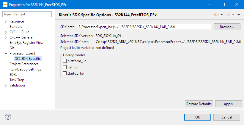

I want to change SDK to SDKs32k ,when generating or creating project from the s32k design studio .
is it possible ?
thanks
Rajesh Kota
1,299 Views
BlackNight
The SDK setting is here:
I hope this helps,
