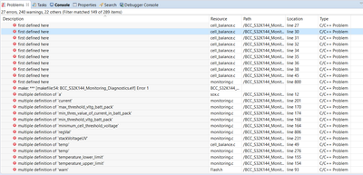

Actually I want to edit the program which was developed using Kinetics software. Now when I tried to add component I want to enable the processor expert changes so  I have added S32K144_SDK and then I enabled processor expert changes . After making this change many error shown which were not before I start editing my program.
Please help to resolve this.

I would like to help you of course, but may you tell me, please, how are you thinking to port a Kinetis code to a S32K ? And which IDE/Tool you are using for? Because it is unclear to me.
Also, I know that Processor Expert does not support S32K, as it is shown here on supported devices: https://www.nxp.com/design/software/development-software/processor-expert-software/processor-expert-...
