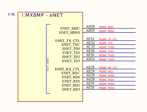

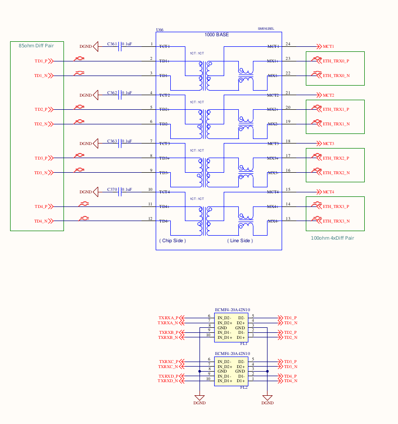

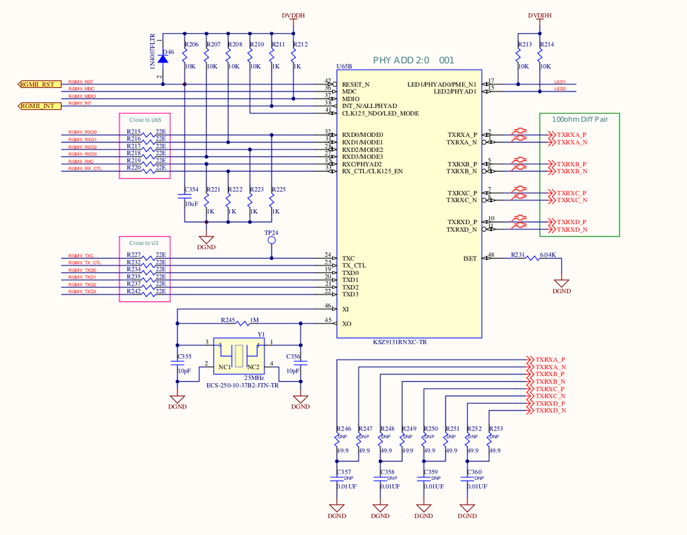

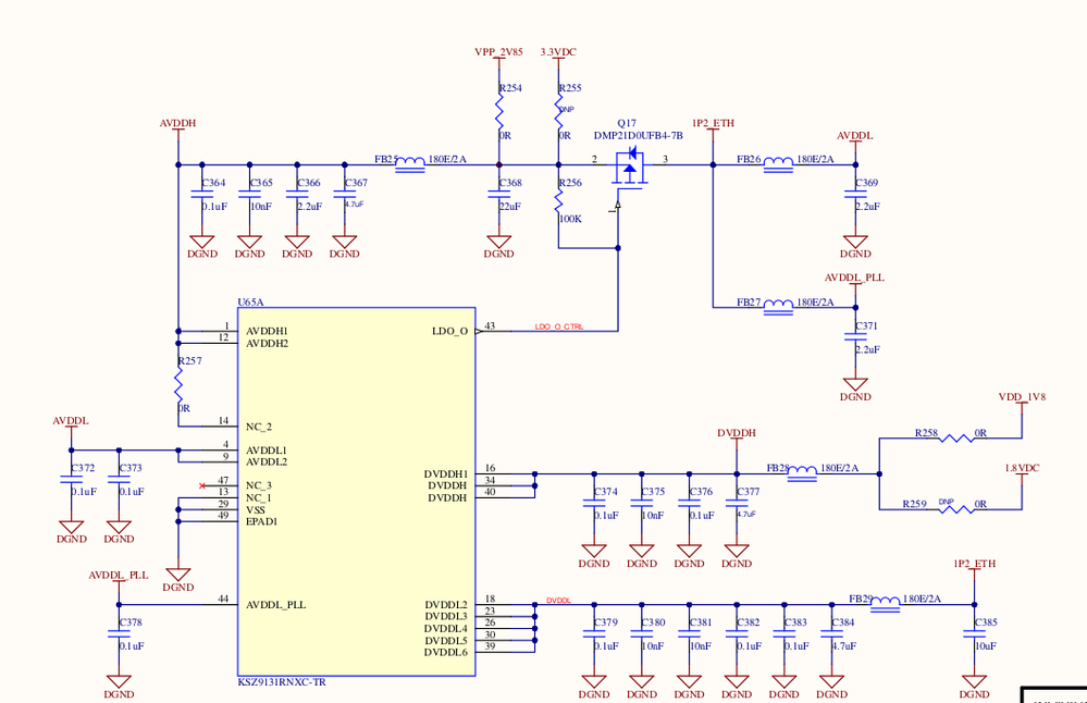

I am working on a imx8mp based custom board. I am using single ethernet of eqos port and KSZ9131 ethernet Phy.  I have disabled feos and configured eqos RGMI interface as per our schematic design.

I am facing an issue that the board sometimes gets an IP address and sometimes doesnot get IP.  When I checked dmesg, I found that sometimes the ethernet link goes up and down continuously and getting below logs.

I have disabled TSN as guided in https://www.nxp.com/design/design-center/software/development-software/real-time-edge-software:REALT...
I also try to disable VLAN Filtering, still getting the same issue.  Sometimes reducing speed by "ethtool -s eth0 speed 100" works but not all times.
Can someone help me to understand the debug the issue.
7 Replies
6,337 Views
JosephAtNXP
Thank you for your interest in NXP Semiconductor products,
What is the BSP that you used for your board?
I would disable VLAN filtering and IEEE capabilities so I can isolate the issue into the lower layers of HW. Conserving this methodology, I would try to to get an static IP to see if it's still happening.
The possible tests are board to board and board to router as well, with static IP and sending ping packets, also, try monitoring the PHY LINK STATUS, does it fail?
Do your RGMII probes matches the RGMII standard? There is often an electrical mismatch that leads to an issue with PHY link.

For electrical mismatch, the hardware team is checking the RGMII specifications.
