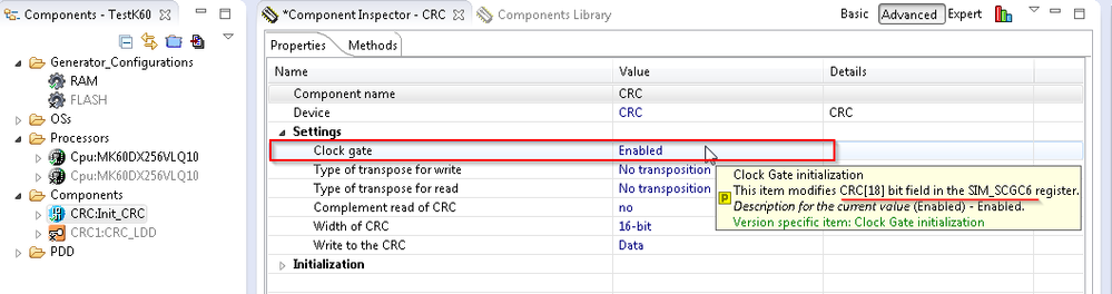

I rercently work with k60. In the processor Expert, how to enable the CLOCK for CRC configuration?
I want processor expert enable CRC so it can generate some like this
  SIM_SCGC6 |= (uint32_t)0x00040000UL;

If you'd like to use CRC pripheral you need to add one of these components  to the project (using  the Components Library view):
- The CRC_LDD provides both initialization code and also methods (functions) for runtime use like GetCRC8, getCRCResult etc. In this case the clock gate is automatically enabled.
- The Init_CRC provides just initialization. You can control clock gate initialization by the property Clock Gate as you can see on the following picture:
