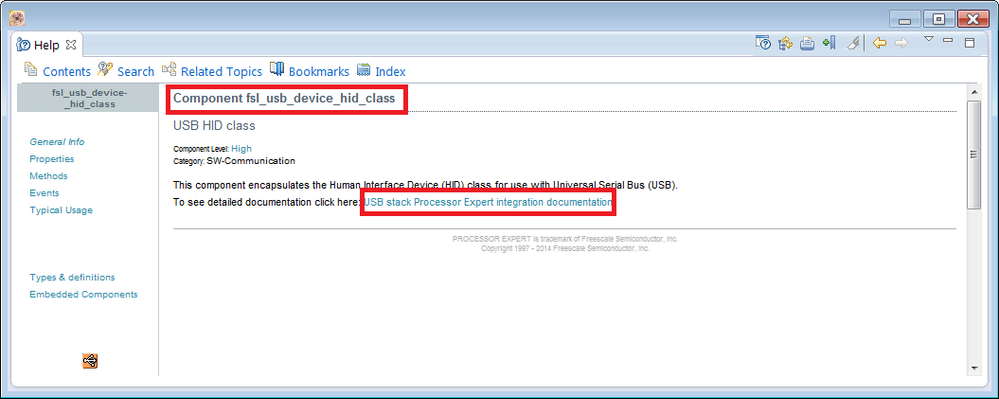

When you open the Help of the fsl_usb_device_hid_class component (in the Components window, select the fsl_usb_device_hid_class component, open the context menu, select Help on Component, open
"Component fsl_usb_device_hid_class 1.1.0-GA" page). This general description of fsl_usb_device_hid_class component contains a link to the Processor Expert Kinetis SDK USB Stack Integration User Guide (see the screenshot below). See the chapter 2.2 fsl_usb_device_hid_class component that contains also a demo description.

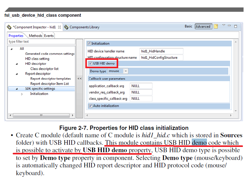

marek_neuzil
Hello Gaston,
The USB HID demo is described in the USB Stack Processor Expert Integration documentation user guide (see how to open this document my response above).
The USB HID demo is integrated in the fsl_usb_device_hid_class component, see the following instructions in the user guide:
