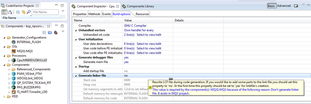

In my cw 10.6 I would like to regenerate the linker file. But the processor expert shows me a grayed field that I cannot change from no to yes. It tells ke that the file already exists. This is true but where do I have to delet it to get the option back--

the attached screenshot shows what I tried to describe.
The *.ld file is later added at: C/C++ Bild -> Settings -> Tool Settings -> ARM Ltd Windows GCC C Linker -> General -> Script file (-T)

Ok, I see it now: the reason why it is disabled is because you are using MQX. It seems that the MQX component creates its own linker file, and disables that you can change that in the CPU component.

That project you have in the screenshot seems to be for the BSP. The option is disabled because it makes no sense to generate a linker file for the MQX BSP library. As you mentioned, the file is actually referenced from the application.
It seems you cloned that BSP from another board, so you should find a default (not modified) linker file in the path C:\Freescale\Freescale_MQX_4_1\mqx\source\bsp\<Board>\<Toolchain>.
