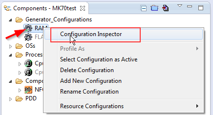

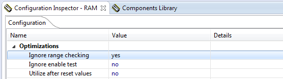

The configuration inspector can be invoked using the pop-up menu of the configuration  (the settings are specific for configuration, you can have different settings for each configuration)::
There you can set "Ignore range settings" :
Then regenerate the code and the range checking code disappears.
