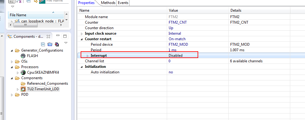

I am using MKE02 and I need to configure a timer in order to obtain a simple WAIT function for my code.
I am thinking about using the component TimerUnit_LDD but I'm not able to make it work in polling mode (without interrupt).
Thank you in advance,
Alessandro
1,478 Views
Hello Alessandro,
Yes, you can use the component of Timer_LDD , and if you do not want use the interrupt ,
you can disable it on the configuration of the Timer_LDD component view :
Then you can configure the Period of timer to 1ms, then write a WAIT function to check the flag of timer,
when the flag set to 1, it meaning delay 1ms.
And there is a WAIT function use this component of Timer_LDD , it use the interrupt , while the principle is the same , i think you can refer to .
