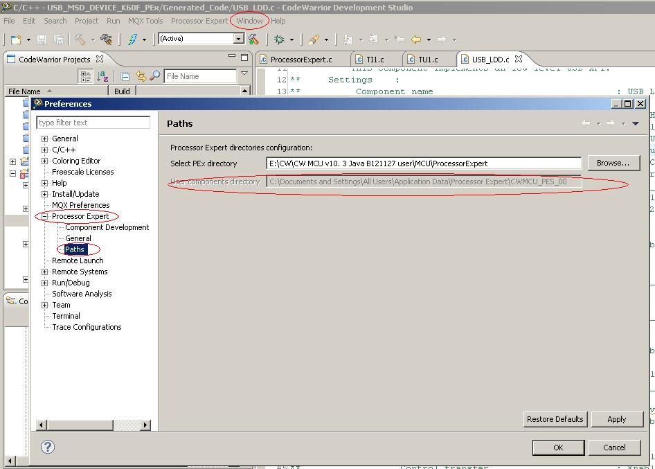

I am having trouble getting the USB_CDC_CLASS component working in Processor Expert.
Freescale USB Stack Version: 4.0.2
Processor Expert Version: 10.0.0
Target MCU: MK60FN1M0VLQ12
The problem is that the inherited USB_LDD wants "Dual Speed" for "Device Data Rate". Is that a usb class requirement to be able to switch to low speed?
I want to use the internal USB SIE for that.
How do i configure either the USB Stack or the USB_LDD so that i can use the USB_CDC_CLASS component without error? Also, how can i deactivate the USB Device in specific speed modes?
Thankful for any help,
martin

There is a problem with the USB_DEVICE_STACK component that the speed setting is read only and it expects Full speed to be set, which might on some devices not be the default setting.
As a workaround, please do the following:
1) Find your „User components directory“ – see attached picture
2) Change line 62 in the „User components directory\Beans\USB_DEVICE_STACK\USB_DEVICE_STACK.chg“ file
from
        %set @LDD_Component@PHY_USB_DEVICE_Speed ReadOnly True
to
        %set @LDD_Component@PHY_USB_DEVICE_Speed ReqValue Full speed=USB_DEVICE_STACK component requirement
3) Reload your project
best regards
Petr Hradsky
Processor Expert Support Team

mentair
Thanks for the explanations, however I am aware of how to set the USB speed modes in independent USB_Ldds.  My Problem is that the USB_CDC_CLASS component preselects everything, including the USB speed mode (which it sets to "dual speed", which the USB_Ldd component complains about). Also I am trying to use the _internal_ USB SIE, not the external ULPI interface.
The other thing is trying to deactivate the component in specific clock configurations in "CPU clock/configuration selection", which is no problem using the Ldd directly, but the USB_CDC_CLASS does not seem to contain the usual clock configuration settings.
I have attached pictures to illustrate the problem.
regards,
martin

mentair
It seems that did the trick.  I got it to generate the sources, but didn't have the chance to check if the code is working yet.
Thanks.
