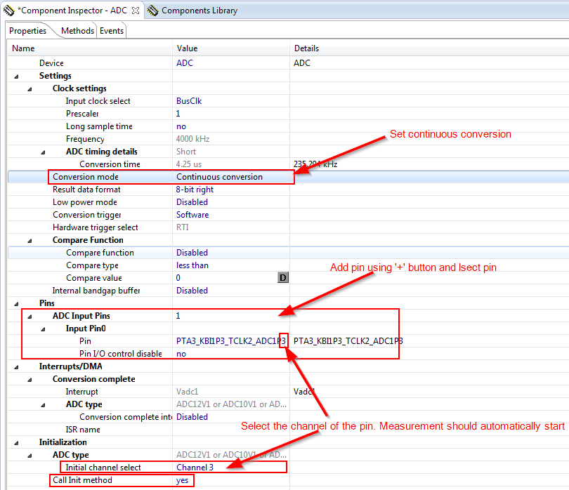

Regarding the Init_ADC example - unfortunately, I don't have any example for that . However, the settings should be quite straightforward, here is a screenshot of example what should work (but haven't tried it on hardware):

Petr_H
Yes, I think that it should work. You need to access the counter register directly (TPMCNT) because there are no methods for this in capture.
You should also expect that there might appear some issues at limit values with overflowing the counter while you read it.

Last question, can I also use the TempSensor with init_ADC? This option does not appear in the input pins list.
D
7,238 Views
Petr_H
You are welcome.
That's correct, the Pins group contains only physical pins allocation. To measure temprreature sensor, just select "Temperature sensor" at "Initial channel select" property. There do not have to be any pins configured for this.

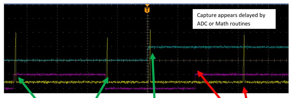

Probably a simple question, but what "time" is actually captured? The time the ISR was entered or the time of the actual event?
This is probably the easiest way to look at what I suspect is the problem, every x edges I am still getting a late ISR I suspect is caused by the ADC or math performed. Does the time stamp correspond to the actual edge timing (left red arrow) or the time the ISR was serviced (right red arrow)?

Petr_H
From your description, it seems that your application is reaching the timing limits...
I suggest to measure the time of processing code for the values itself (without any capture or ADC), if it's short enough to get between the lowest intervals that can occur. If not, you would need to optimize it or change the micro-controller to something more powerful.
If it's OK, the possible directions of improvement could be the following :
1. Try to increase optimization level of the compiler.
2. Use Init_ADC component instead of ADC, configure it and select "Continuous  conversion" mode. This means that ADC performs continuously and you can just grab results from the ADC result register (ADCRH, ADCRL). This would allow to avoid some overhead in ADC functions
3. Disable interrupts in capture components and read both of  them it in periodic manner using method GetCaptureValue. For example in some periodic timer interrupt or elsewhere. This period would have to be lower than the lowest period of the signal.
4. Use Init_TPM component, add there two channels and set them for capture and then write you own code directly handling the TPM registers to avoid overhead in 'Capture' component code.
