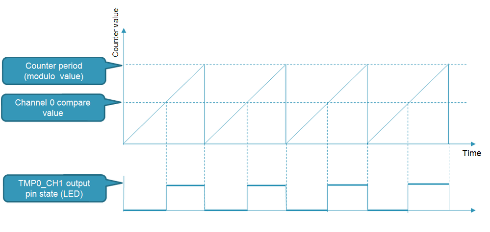

Timer Operation Description
The Timer/PWM Module 0 (TPM0) provides (besides other features) a counter with variable period (modulo), compare register an output pin suitable for the goal of periodic toggling.
The counter will be configured to continuously run in modulo range with a 300ms period, the output will be set when counter reaches the compare register value (150ms) and cleared when the counter resets.
The following picture describes the operation:

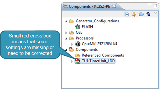

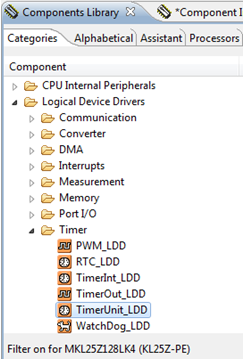

  • Switch to Components Library view and its Categories tab and add the TimerUnit_LDD component from the category Logical Device Drivers / Timer by double-clicking on it or selecting pop-up menu command ‘Add to project’.
  • The component appears in the Components view:
  • Use the Rename component command from the TU1’s context menu and change the name to BlueLED. :

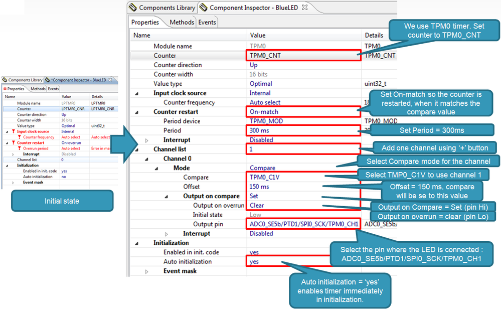

  • Double click the component to open it in the inspector and configure the properties according to the following picture:

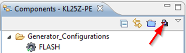

  • Invoke code generation by clicking on the Generate Processor Expert Code button in the Components view of the project:

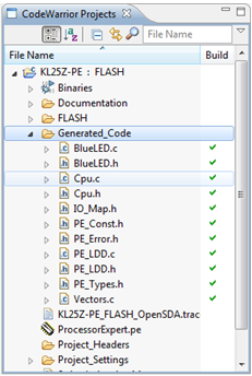

  • The generated code is present in the Generated_Code folder of the project:
Note: The generated code contains automatic initialization provided by Processor Expert configuring all needed registers, so it's not necessary to write any user code.

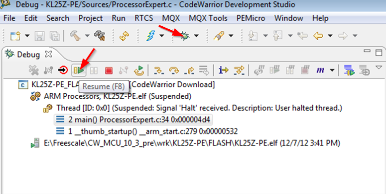

  • Build the project using the Project / Build All.
  • After the successful build, you can connect the FRDM-KL25 board and run the application by clicking the "Debug" icon and after the code gets loaded into the board the "Resume" button.
  • The LED should start periodically blinking with blue color.
