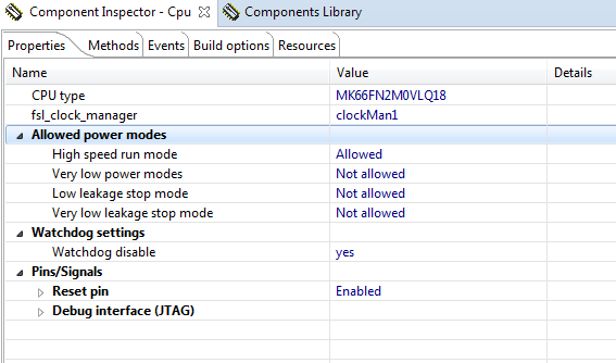

When using K66 to set up 180 MHz high speed mode the SMC->PMPROT register must be set to allow high speed mode. In KSDK 1.2.0 system_MK66F18.h sets SYSTEM_SMC_PMPROT_VALUE to 0. Since this register is a one time writeable after reset it is not possible to change this.
Basic objective should be that Processor Expert clock configuration should be possible to use also for high speed mode.
/Peter
Realized that this is a processor expert question only...

you can set in in CPU component. Anyway we will improve this in next release of ProcessorExpert for Kinetis SDK.
best regards
Vojtech Filip
